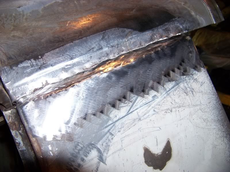

I had some time this morning to go out (sneak out)  and go work on it . I crimped the edge of the hole were the sunroof was. and cut  a pattern out of some sheet metal. now I will take that to the camero roof and lay it out on the roof and cut my patch.  I wish I had an English Wheel, then I could use the pattern I just made.  but I realy like cutten on a camero.  ;D
some don't like to lap the sheet metal, but doing it this way makes it a lot stronger and its flush when done.

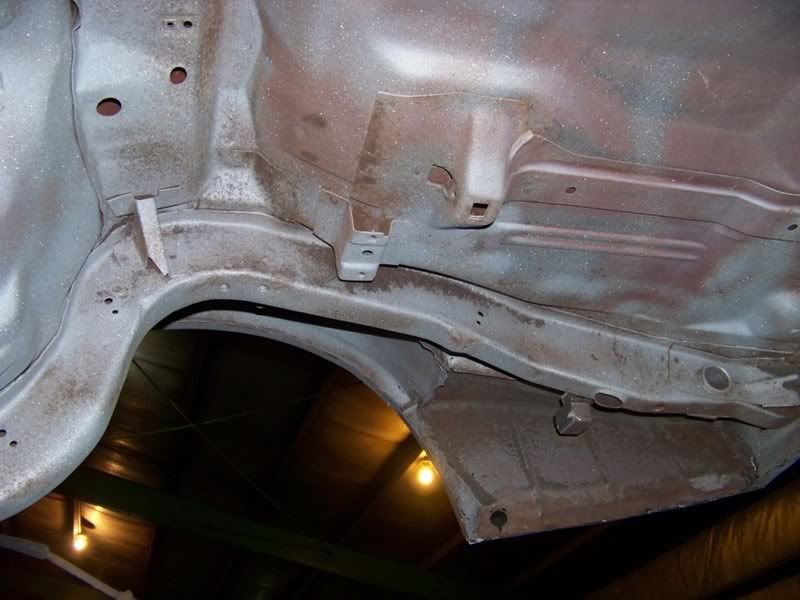

 I got the rear end out, brake& gas lines off. its really not to bad under there. surface rust, that's it . rear tail panel does not have a pin hole in it. it has never been undercoated. oil and trans fluid up front. I still need to weld and grind the floor patch from underneath to make it right.  well I guess it time to start scrapping and wire wheeling. uuuuug I hate this part of it.  need to start on the left side rocker to.
here's a bunch of pics

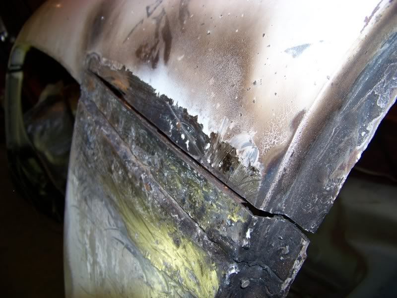

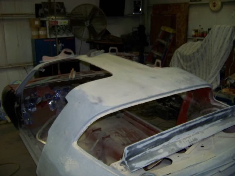

Post by: 4SPEED on December 23, 2009, 07:55:32 PM

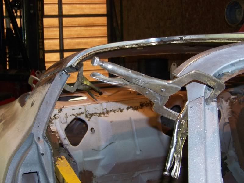

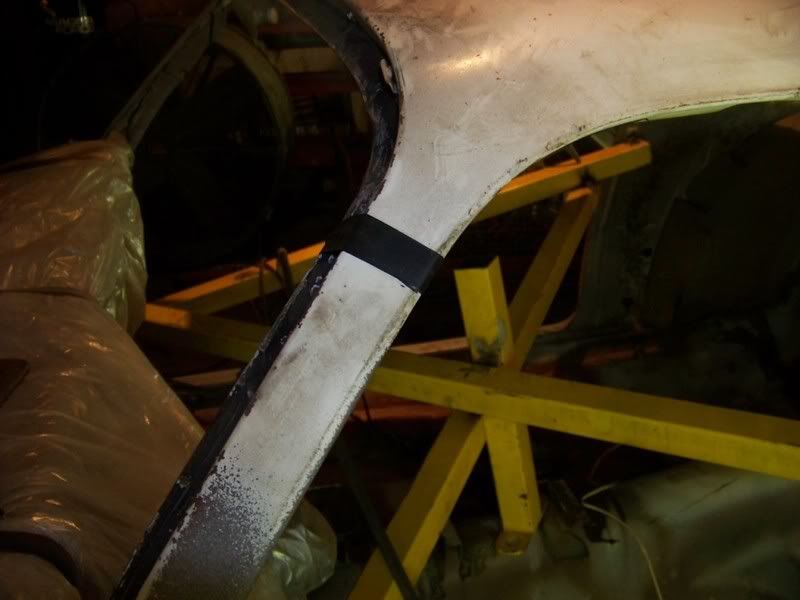

well today was the day. I did it. ( the roof swap)  it's really not that bad to do. easy really.  I don't no if the way I did it is right or wrong. but here go's
first I measured 15" up the front posts. marked them the best I could. on the donor car I measured  up 14 15/16" due to the cutting disk is about 1/8" thick.  and cut one car on one side of the line (top) and cut the other car on the other side of the line (bottom).
on the sail panel , I took a propane torch and melted the led out to get to the seem.  and cut above the seem about an inch. after the roof is off , then take off the 1" piece of roof on the seem.
do the opposite for the donor car cut the sail panel about an inch below the seem. and lay it on some saw horses to clean it up.
after you get the new roof and the car cleaned up your ready to mach them up.

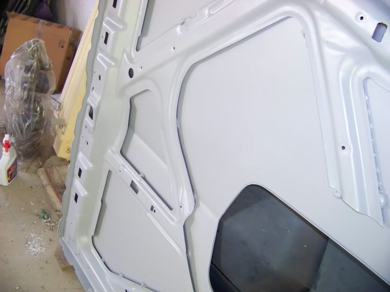

Title: Re: 77 W72 trans am Restoration
Post by: 4SPEED on December 23, 2009, 07:56:33 PM

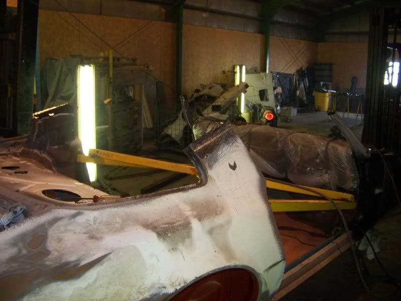

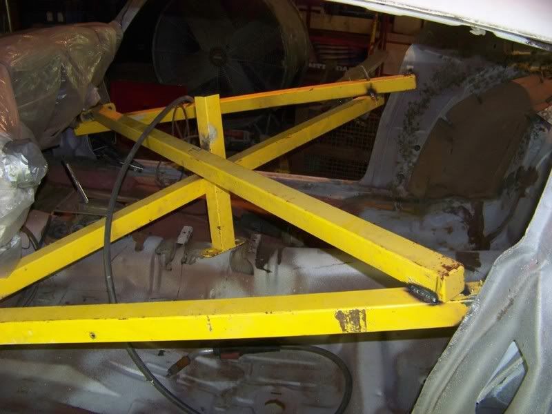

I forgot , first I put some steal in it to strengthen the body
here is the new roof.

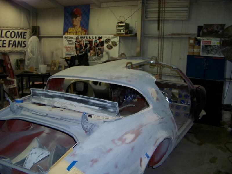

today I  got the t-top track out, welded the inside of the sail panels,  stripped all the paint and cut the bad part of the rocker off.
tomorrow I will epoxy prime the body except for the rocker

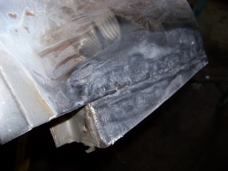

Title: Re: 77 W72 trans am Restoration (roof swap)
Post by: 4SPEED on December 31, 2009, 07:40:58 PM
another way to fix a hole  ;D
cut away the rust
get a 1/4" bar of copper. clamp it behind the hole. the wire weld will not stick to the copper and makes the weld on the inside smooth.
done
other spot I fixed today
finely done with sheet metal work, time to make it RED. ;)
got the glass on the welds and seams

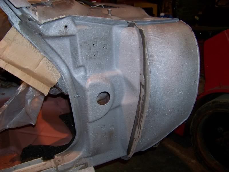

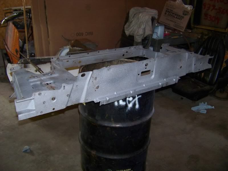

Post by: 4SPEED on January 06, 2010, 12:42:18 AM
work on some more parts
took apart and sand blasted
painted and put back together. I like it.
and did some more work on the sub frame.

more work done
first coat of urethane 2k primer , for block sanding.
Post by: 4SPEED on November 06, 2010, 08:40:08 AM
the roof was just too wavy for the color its going to be.
bullet proof,  the new eaton diff is installed  :)
the body is about ready, so I thought I would prep the under side for paint.  I started  to dry sand it with 400 grit. to take the smooth off the epoxy so the paint will stick.   the frame had rust pits in it.  and the more I thought about what it would look like painted , the more it bugged me.  so now I'm filling the pits.
the paint is a Dr. jekyll mix from my paint supply place.  a base/clear and the clear is a semi gloss.
no more pits.   and I tryed to get a pic of the paint.  the pic doesnt really show what it looks like.  but its really close to a piece I have with 70's primer on it. one pic with and with out the flash.
I also worked the front floor toe area that I replaced.  it looked like crap.
before
you can see the lap of the toe and floor is backwards.  so with a little trimming ,welding and the magic of glass work , it looks like this now.
Post by: 4SPEED on November 10, 2010, 04:12:07 PM
I'm good!  ;)    I would hate to pay someone to do this.  there is about 20hr's in it.
